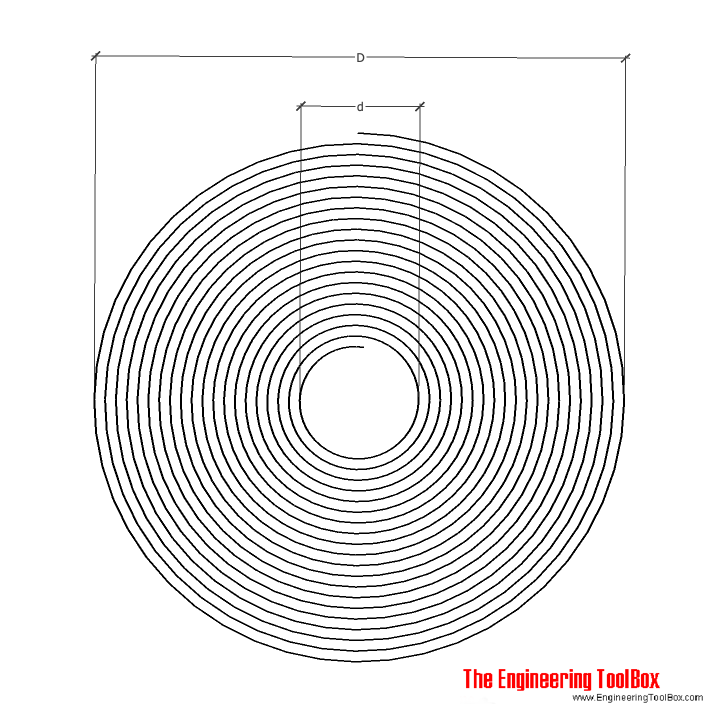

The length of a spiral can be calculated as
L = 3.14 n (D + d) / 2                  (1)
L = length of spiral (m, ft ...)
n = number of rings
D = spiral outside diameter (m, ft ...)
d = spiral inside diameter or opening (m, ft ...)
The equation can be used to calculate the length of a material of uniform thickness. Typical examples may be belts, garden hoses or ropes in a roll.

Example - Water Solar Heater
A solar heater is made like a coil with 20 mm pipe inside a 1 m x 1 m window frame. The coil is done like a doughnut with an outer radius of 0.5 m and an inner radius of 0.1 m due to the bending limits of the pipe. If the coil is made with no space between the pipes the number of turns can be calculated as
n = ((0.5 m) - (0.1 m)) / (0.02 m)
  = 20
The length of the water pipe in the solar heater can be calculated as
L = 3.14 (20) ((1 m) + (0.2 m)) / 2
  = 37.7 m
