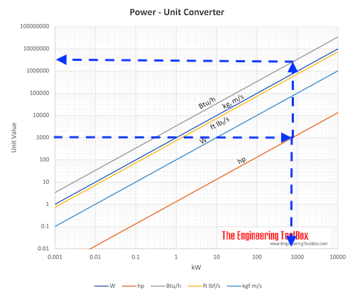

Power - kW versus Horsepower
Power Unit converting chart kW, hp ..
Download and print Power - Unit Converting Chart

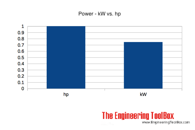

Power can also be expressed in horsepower (hp):
1 kW = 1.341 hp
1 hp = 0.7457 kW
Power - kw versus hp
  • 1 kW = 1000 W = 3412 Btu/h = 737.6 ft lbf/s = 1.3596 hp(M) (ps) = 1.341 hp(I) (bhp) = 101.97 kgf m/s = 737.6 ft lbf/s
  • 1 hp (English horse power, bhp) = 745.7 W = 0.746 kW = 550 ft lb/s = 2545 Btu/h = 33000 ft lb/m = 1.0139 ps (metric horse power) ~= 1.0 KVA
PS (Pferdestärke, horse strength in German) referred to as 'metric horsepower' is replaced by kW as the legal EU measurement of engine power.

Example - 1000 hp
1000 hp can be converted to aprox. 745 kW or 2500000 Btu/h as indicated in the chart below.
Power Unit converting chart kW, hp .. - example
