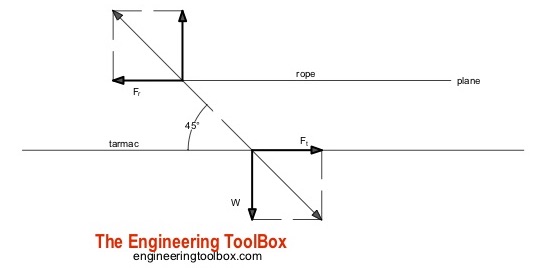

When persons participates in aircraft pulling there is normally an offset between the rope connected to the air craft nose wheel and the tarmac. It is common for persons to bend over with the rope over the shoulder or holding it in the hands.
The horizontal friction force between the persons shoes and the tarmac must be equal or larger than the air plane rolling resistance.  The minimum required vertical force - or minimum weight of the people - depends on the bending angle as illustrated in the vector diagram below.
Forces required to pull an air plane
If they bend over 45 o - the vertical force or weight equals to the horizontal force. With rubber shoes and the same friction coefficient as above for the truck the weight of the people should be 889 kg . With an average weight of 80 kg/person - the number of persons can be calculated to
n = (889 kg) / (80 kg/person)
= 11.1
= 12
With a more realistic bending angle 60 o - the minimum vertical force or weight can be calculated as
W = tan(60 o )  (7848 N)
= 13593 N
The minimum mass of people to achieve this weight can be calculated as
mf = W / a g
= (13593 N) / (9.81 m/s2)
= 1386 kg
With an average weight of 80 kg/person - the minimum number of persons can be calculated to
n = (1386 kg) (80 kg/person)
= 17.3
= 18
