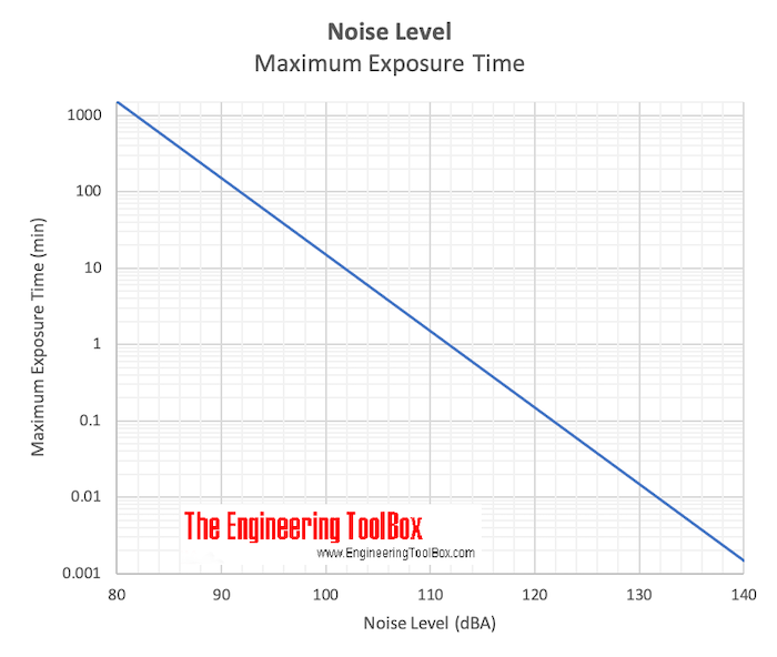

Exposure to noise should be controlled so that it is less than a maximum combination of exposure level and duration.
According the National Institute for Occupational Safety - NIOSH - the exposure to noise should be controlled so that the exposure is less than a max combination of exposure level - L - and duration - t.
The maximum time of exposure at a noise level can be calculated as:
t = 480 / 2(L - 85)/3                                   (1)
t = maximum exposure duration (minutes)
L = noise exposure level (dB(A))
3 = exchange rate (dB)
85 = Recommended Exposure Limit - REL (dB(A))
Maximum human noise exposure - time diagram
Download and print Noise Level - Maximum Exposure Time Chart
