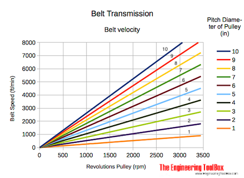

The velocity at which a belt travels may be expressed as
v = π dm nm / 12                                    (2)
v = velocity of belt (ft/min)
nm = revolutions motor (rpm)
- or alternatively in metric units:
vb = π dm nm / 60                         (2b)
vb = velocity of belt (m/s)
dmb = diameter motor pulley  (m)
Belt Transmissions - Belt Speed
Pitch Diameter of Pulley
(in)
Velocity (ft/min)
Revolutions Pulley - n -(rpm)
850105010751140155017253450
1 223 275 281 298 406 452 903
2 445 550 563 597 812 903 1806
3 668 825 844 895 1217 1355 2710
4 890 1100 1126 1194 1623 1806 3613
5 1113 1374 1407 1492 2029 2258 4516
6 1335 1649 1689 1791 2435 2710 5419
7 1558 1924 1970 2089 2841 3161 6322
8 1780 2199 2251 2388 3246 3613 7226
9 2003 2474 2533 2686 3652 4064 8129
10 2225 2749 2814 2985 4058 4516 9032
Belt transmission - pulley and belt velocity
