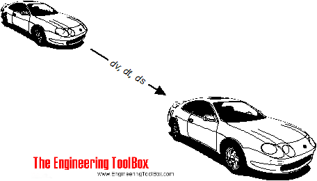

Example - resulting Velocity after an Acting Force
A force 1000 N is acting on a car with mass 1000 kg in 10 second.
Car - acting force and acceleration
The impulse - or change in momentum - can be calculated
I = dM = (1000 N) (10 s)
  = 10000 (N s, kg m/s)
Since momentum can be expressed as
M = m v                                                 (3)
M = momentum (kg m/s, lb ft/s)
m = mass (kg, lb)
v = velocity (m/s, ft/s)
then the velocity of the car after 10 s can be calculated as
v = (10000 kg m/s) / (1000 kg)
 = 10 m/s
 = 36 km/h
