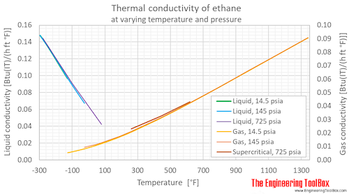

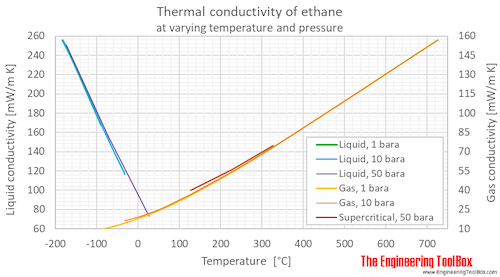

Thermal conductivity of ethane as function of temperature, given as °C and °F, and pressure:
Ethane thermal conductivity pressure C
Ethane thermal conductivity pressure F

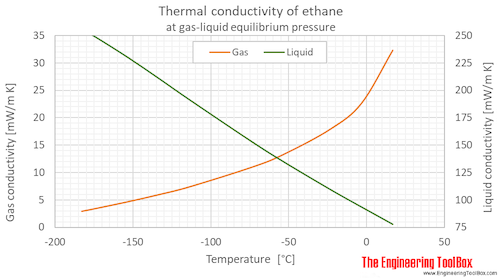

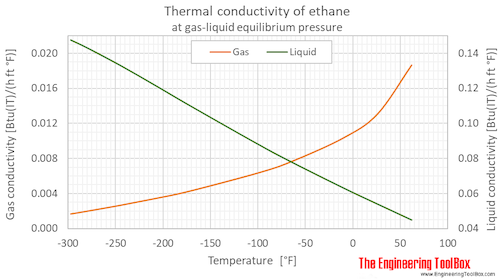

Thermal conductivity of ethane at gas-liquid equilibrium pressure and varying temperature, given as °C and °F:
Ethane thermal conductivity equilibrium C
Ethane thermal conductivity equilibrium F

90.368 -182.78 -297.01 1.14E-05 1.66E-04 255.6 0.2198 0.1477 1.772
100 -173 -280 1.11E-04 1.61E-03 247.8 0.2131 0.1432 1.718
120 -153 -244 3.52E-03 0.0511 229.9 0.1977 0.1328 1.594
140 -133 -208 0.0381 0.55 210.6 0.1811 0.1217 1.460
160 -113 -172 0.21 3.10 190.8 0.1641 0.1103 1.323
200 -73.2 -99.7 2.17 31.5 152.6 0.1312 0.08815 1.058
220 -53.2 -63.7 4.92 71.4 134.6 0.1157 0.07777 0.9332
250 -23.2 -9.7 13.0 189 109.3 0.09397 0.06315 0.7578
270 -3.1 26.3 22.1 321 93.31 0.08023 0.05391 0.6470
290 16.9 62.3 35.2 510 77.57 0.06670 0.04482 0.5379
Gas at
equilibrium
90.368 -182.78 -297.01 1.14E-05 1.66E-04 2.908 2.50E-03 1.68E-03 0.02016
100 -173 -280 1.11E-04 1.61E-03 3.456 2.97E-03 2.00E-03 0.02396
120 -153 -244 3.52E-03 0.0511 4.657 4.00E-03 2.69E-03 0.03229
140 -133 -208 0.0381 0.55 5.966 5.13E-03 3.45E-03 0.04137
160 -113 -172 0.21 3.10 7.422 6.38E-03 4.29E-03 0.05146
200 -73.2 -99.7 2.17 31.5 11.01 9.47E-03 6.36E-03 0.07634
220 -53.2 -63.7 4.92 71.4 13.32 0.01145 0.007695 0.09234
250 -23.2 -9.7 13.0 189 17.93 0.01542 0.01036 0.1243
270 -3.1 26.3 22.1 321 22.67 0.01949 0.01310 0.1572
290 16.9 62.3 35.2 510 32.32 0.02779 0.01867 0.2241
Liquid
90.38 -182.77 -296.99 1 14.5 255.6 0.21983 0.1477 1.772
100 -173 -280 1 14.5 247.9 0.2132 0.1432 1.719
120 -153 -244 1 14.5 230.0 0.1978 0.1329 1.595
140 -133 -208 1 14.5 210.6 0.1811 0.1217 1.460
160 -113 -172 1 14.5 190.9 0.1641 0.1103 1.324
180 -93.2 -136 1 14.5 171.4 0.1474 0.09903 1.188
184.33 -88.82 -127.88 1 14.5 167.2 0.1438 0.09661 1.159
Gas
184.33 -88.82 -127.88 1 14.5 9.471 8.14E-03 5.47E-03 0.066
200 -73.2 -99.7 1 14.5 10.72 9.22E-03 6.19E-03 0.074
220 -53.2 -63.7 1 14.5 12.47 0.01072 7.21E-03 0.086
240 -33.2 -27.7 1 14.5 14.39 0.01237 8.31E-03 0.0998
260 -13.2 8.3 1 14.5 16.48 0.01417 9.52E-03 0.1143
280 6.9 44.3 1 14.5 18.76 0.01613 0.01084 0.1301
300 26.9 80.3 1 14.5 21.22 0.01825 0.01226 0.1471
320 46.9 116 1 14.5 23.85 0.02051 0.01378 0.1654
340 66.9 152 1 14.5 26.65 0.02291 0.01540 0.1848
360 86.9 188 1 14.5 29.61 0.02546 0.01711 0.2053
400 127 260 1 14.5 35.96 0.03092 0.02078 0.2493
500 227 440 1 14.5 53.77 0.04623 0.03107 0.3728
600 327 620 1 14.5 73.34 0.06306 0.04238 0.5085
700 427 800 1 14.5 93.86 0.08071 0.05423 0.6508
800 527 980 1 14.5 114.8 0.09871 0.06633 0.7960
900 627 1160 1 14.5 135.9 0.1169 0.07852 0.9423
1000 727 1340 1 14.5 156.8 0.1348 0.09060 1.087
Liquid
90.53 -182.62 -296.72 10 145 255.9 0.2200 0.1479 1.774
100 -173 -280 10 145 248.3 0.2135 0.1435 1.722
120 -153 -244 10 145 230.5 0.1982 0.1332 1.598
140 -133 -208 10 145 211.2 0.1816 0.1220 1.464
160 -113 -172 10 145 191.6 0.1647 0.1107 1.328
180 -93.2 -136 10 145 172.1 0.1480 0.09944 1.193
200 -73.2 -99.7 10 145 153.3 0.1318 0.08858 1.063
220 -53.2 -63.7 10 145 135.2 0.1163 0.07812 0.9374
240 -33.2 -27.7 10 145 117.6 0.1011 0.06795 0.8154
241.1 -32.1 -25.7 10 145 116.6 0.1003 0.06737 0.8084
Gas
241.1 -32.1 -25.7 10 145 16.36 0.01407 9.45E-03 0.1134
260 -13.2 8.3 10 145 17.92 0.01541 0.01035 0.1242
280 6.9 44.3 10 145 19.91 0.01712 0.01150 0.1380
300 26.9 80.3 10 145 22.18 0.01907 0.01282 0.1538
320 46.9 116 10 145 24.67 0.02121 0.01425 0.1710
340 66.9 152 10 145 27.36 0.02353 0.01581 0.1897
360 86.9 188 10 145 30.24 0.02600 0.01747 0.2097
400 127 260 10 145 36.46 0.03135 0.02107 0.2528
500 227 440 10 145 54.08 0.04650 0.03125 0.3750
600 327 620 10 145 73.56 0.06325 0.04250 0.5100
700 427 800 10 145 94.03 0.08085 0.05433 0.6520
800 527 980 10 145 115.0 0.09888 0.06645 0.7973
900 627 1160 10 145 136.0 0.1169 0.07858 0.9430
1000 727 1340 10 145 156.9 0.1349 0.09066 1.088
Liquid
100 -173 -280 50 725 250.2 0.2151 0.1445 1.735
200 -73.2 -99.7 50 725 157.0 0.1350 0.09071 1.088
300 26.9 80.3 50 725 73.07 0.06283 0.04222 0.5066
Supercritical
phase
400 127 260 50 725 39.97 0.03437 0.02310 0.2772
500 227 440 50 725 55.98 0.04813 0.03234 0.3881
600 327 620 50 725 74.80 0.06432 0.04322 0.5186
Liquid
91.96 -181.19 -294.14 100 1450 258.6 0.2224 0.1494 1.793
100 -173 -280 100 1450 252.5 0.2171 0.1459 1.751
120 -153 -244 100 1450 235.4 0.2024 0.1360 1.632
140 -133 -208 100 1450 216.9 0.1865 0.1253 1.504
160 -113 -172 100 1450 197.9 0.1702 0.1143 1.372
180 -93.2 -136 100 1450 179.3 0.1542 0.1036 1.243
200 -73.2 -99.7 100 1450 161.4 0.1388 0.09326 1.119
220 -53.2 -63.7 100 1450 144.4 0.1242 0.08343 1.001
240 -33.2 -27.7 100 1450 128.5 0.1105 0.07425 0.8910
260 -13.2 8.3 100 1450 113.6 0.09768 0.06564 0.7876
280 6.9 44.3 100 1450 99.57 0.08561 0.05753 0.6904
300 26.9 80.3 100 1450 86.39 0.07428 0.04992 0.5990
Supercritical
phase
320 46.9 116 100 1450 73.81 0.06347 0.04265 0.5118
340 66.9 152 100 1450 62.21 0.05349 0.03594 0.4313
360 86.9 188 100 1450 53.36 0.04588 0.03083 0.3700
400 127 260 100 1450 48.70 0.04187 0.02814 0.3377
500 227 440 100 1450 59.52 0.05118 0.03439 0.4127
600 327 620 100 1450 76.88 0.06610 0.04442 0.5330
700 427 800 100 1450 96.40 0.08289 0.05570 0.6684
800 527 980 100 1450 116.8 0.1004 0.06749 0.8098
900 627 1160 100 1450 137.5 0.1182 0.07945 0.9534
1000 727 1340 100 1450 158.2 0.1360 0.09141 1.097
Liquid
100 -173 -280 300 4351 261.510 0.2249 0.1511 1.813
200 -73.2 -99.7 300 4351 177.270 0.1524 0.1024 1.229
300 26.9 80.3 300 4351 112.640 0.09685 0.06508 0.7810
Supercritical
phase
400 127 260 300 4351 81.974 0.07048 0.04736 0.5684
500 227 440 300 4351 78.720 0.06769 0.04548 0.5458
600 327 620 300 4351 88.635 0.07621 0.05121 0.6145
