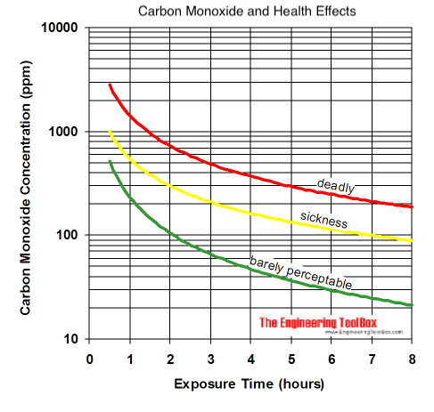

Health effects of Carbon Monoxide
CO - Carbon Monoxide - Health Effects
Exposure
(hours)
CO Concentration
(ppm)1
PerceptibleSickness3)Deadly4)
0.5 600 1000 2000
1 200 600 1600
2 100 300 1000
4 50 150 400
6 25 120 200
8 252) 100 150
1) ppm - parts per million - is defined as the mass of the component in solution divided by the total mass of the solution multiplied by 106 (one million)
2) The maximum exposure allowed by OSHA in the workplace over an eight hour period is 35 ppm.
3) Typical sickness symptoms are mild headache, fatigue, nausea and dizziness.
4) A CO concentration of 12-13000 ppm is deadly after 1-3 minutes. A CO concentration of 1600 ppm is deadly after one hour.
Carbon monoxide - dangerous health effects vs exposure time diagram
