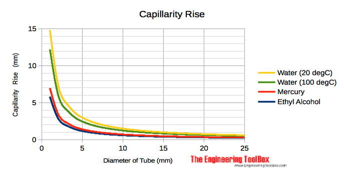

The height of liquid in a tube due to capillarity can be calculated
h = 2 σ cosθ / (ρ g r)                              (1)
h = height of liquid (ft, m)
σ = surface tension (lb/ft, N/m)
θ = contact angle ( θ = 0 for clean tube)
ρ = density of liquid (lb/ft3, kg/m3 )
g = acceleration of gravity (32.174 ft/s2, 9.81 m/s2)
r = radius of tube (ft, m)
Surface Tension
Surface tension is typically measured in dynes /cm or N/m .
Capillarity - Surface Tension vs. Liquid
LiquidSurface Tension
- σ -
N/m dynes/cm
Ethyl Alcohol 0.0223 22.3
Mercury 0.465 465
Water 20 oC 0.0728 72.75
Water 100 oC 0.0599
58.9
Capillarity, like surface tension, decreases with increasing temperature. The temperature variation, however, is small and insignificant in most problems.
Example - Water Capillarity Rise in Tube
The capillarity rise in a clean tube (θ = 0) with diameter 2 mm and water temperature 20 oC with density 1000 kg/m3 can be calculated as
h = 2 (0.0728 N/m) cos(0) / ((1000 kg/m3 ) (9.81 m/s2) (2 10-3 m))
= 0.0074 m
= 7.4 mm
