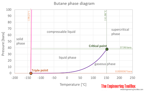

The phase diagram of butane is shown below the table.

Butane is a gas at standard conditions. However, at lower temperature and/or high pressures the gas becomes a liquid or a solid.
The butane phase diagram shows the phase behavior with changes in temperature and pressure. The curve between the critical point and the triple point shows the butane boiling point with changes in pressure. It also shows the saturation pressure with changes in temperature.
Butane phase diagram
