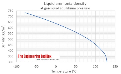

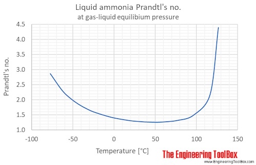

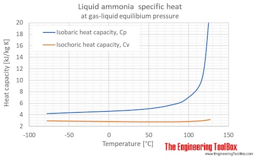

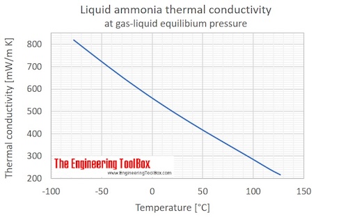

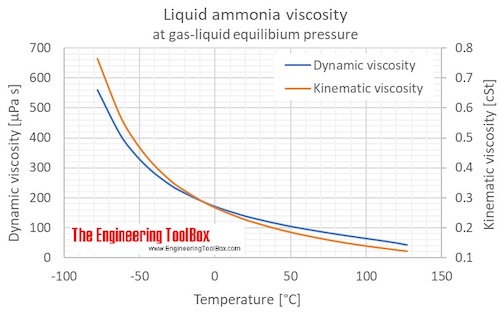

Below the tables, properties of liquid ammonia at saturation pressure as function of temperatur, are shown in figures.

Liquid ammonia density saturation pressure C
Ammonia liquid heat capacity Cp C
Liquid ammonia thermal conductivity saturation pressure C Ammonia liquid heat capacity C
Liquid ammonia Prandtl saturation pressure C
