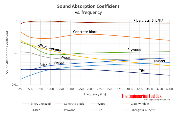

1) Note! - the sound absorption coefficient varies with frequency.
Sound absorption coefficent vs. frequency
